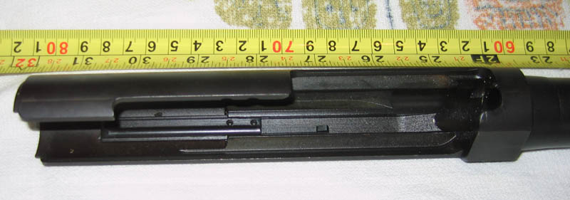

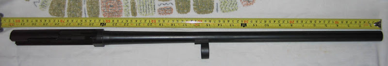

tlivingd Posted December 24, 2010 Share Posted December 24, 2010 I was given a barrel that I was told was from a Benelli but no idea of the model. The shotgun was purchased new around 1999-2000 along with this barrel. The shotgun is no longer in our possession. Can anyone help me ID this further? The markings on the barrel are E.R. Shaw Custom Slug Barrel 12ga 2 3/4" & 3' Chamber (yes it shows 3' on the barrel I know it should be 3") Thanks for any help, Nate I'd have pictures but my post count isn't high enough. however if you go to gunandgame and search for Benelli it's the second link Quote Link to comment Share on other sites More sharing options...

tlivingd Posted December 25, 2010 Author Share Posted December 25, 2010 (edited) oh actually I learned it's a Super Black Eagle. although I don't know if it's the SBE II version. Does anyone know when SBE II came out? Edited December 25, 2010 by tlivingd Quote Link to comment Share on other sites More sharing options...
tlivingd Posted December 25, 2010 Author Share Posted December 25, 2010 It has no sights. I think it's been drilled for a scope mount. however the two holes are only about 1" apart. though I don't have a picture showing those yet. it's unfired and never even been mounted on the gun. Quote Link to comment Share on other sites More sharing options...
tlivingd Posted December 25, 2010 Author Share Posted December 25, 2010 I don't know if it needs a different fore-stock Quote Link to comment Share on other sites More sharing options...

GoBow Posted December 25, 2010 Share Posted December 25, 2010 Shaw made slug barrels for Benelli. They also made several versions; sights/no sights, 1:28", 1:36". My SBE has a no sight, 1:28", very accurate. Best of luck with yours. Quote Link to comment Share on other sites More sharing options...
OldFlick Posted January 6, 2011 Share Posted January 6, 2011 E R Shaw is still in business, do a internet search. That barrel should be a SBE(will fit a SBE II) barrel. They made slug barrels for Benelli for many years. It has heavier walls than newer barrels and needs a special forearm, or sanding for stock forearm. It is a 2 3/4 or 3" only barrel. A valuable and good barrel. Do you want to sell? I know people looking for them as around here there are few rifle areas. Quote Link to comment Share on other sites More sharing options...
