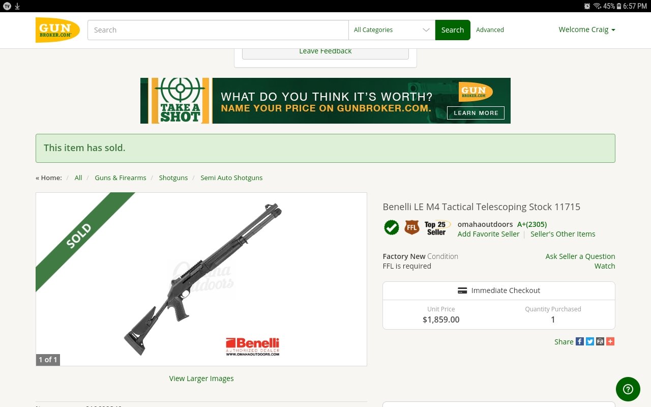

Hey guys. Not to step on anyone's toes on this thread, but this all concerns me also, as of the week before last!! Lol. I got the M4 H20 model. I did get the fixed stock, so now I am in search of the collapsible... One on EBAY for $459 or something REDICULOUS like that. But I went on Benelliparts.net and it is letting me purchase one, or so it appears. It is the all black, but I don't care. They are also charging $399(WTF???) I thought it was supposed to be $249 through Benelli? The is a space for a "Coupon Code", but the internet is full of BS ones that don't work. Does anyone know where I can get one cheaper or a code I can use? I also need the 7 Round NP3 Titanium Mag Tube(Wish they made a full length Carbon Fiber... That would be cool!).. Anyway, please let me know if you guys have any idea. Or if Stranger Danger happens to see this. Anyone here can respond to me here, or my email at [email protected]... Just if anyone has the time. Thank you all!! This is a great Forum, BTW!

They were $249 but benelli doesn't sell that part directly to civilians so there will be mark up.  You either go through a reseller (like benelliparts.net) or gunbroker or use your LE credentials and go through your department.
They were $699 or more during the craze of 2012 or so... just FYI

Lately the collapsible stock’s have been hard to find which has caused the price to climb. Benelli doesn’t sell these to the public. The main source for these comes from the Benelliparts owner. I guess he has an Italian uncle or something to get them in bulk. No one knows how or where his source is.

At that price point, you’re better off buying a m1014 and taking the collapsible stock from it then selling that shotgun back off with the regular pistol grip stock on it.
I haven’t seen any stock’s lately. It’s been a dry spell for most of this year. I usually buy mine straight from Benelliparts.
