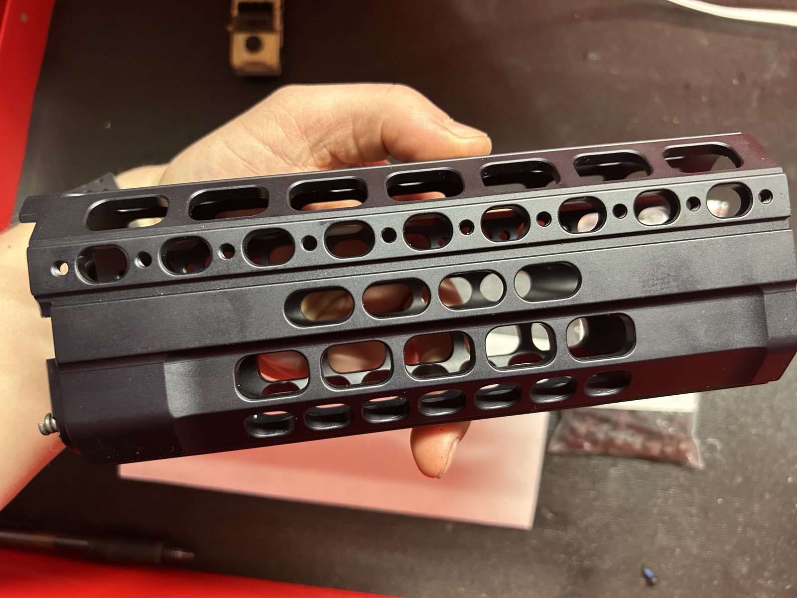

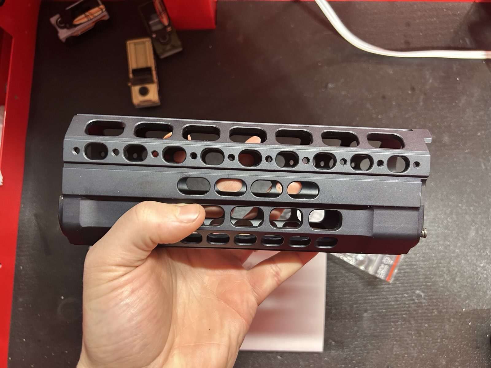

  1. I have a gen 2 entry that I swapped back to the Gen 1. This hand guards are new, I fired one tube to check the pattern then swapped them. Zero scratches, has the rail kit too and the tension springs in them. The handguard goes fro $399 and the rails for $129 from Benelli, asking $325 + shipping for the entire set.

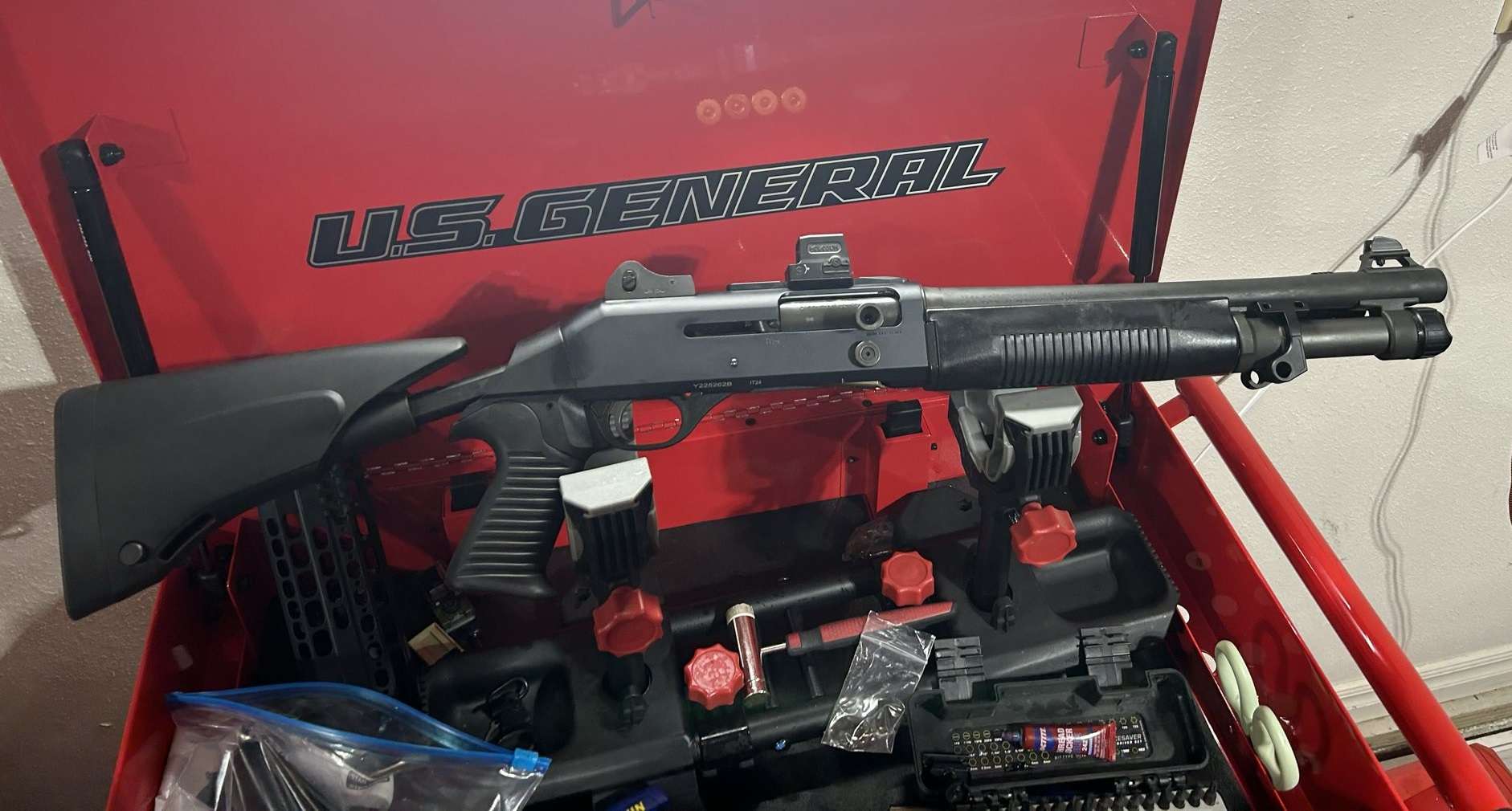

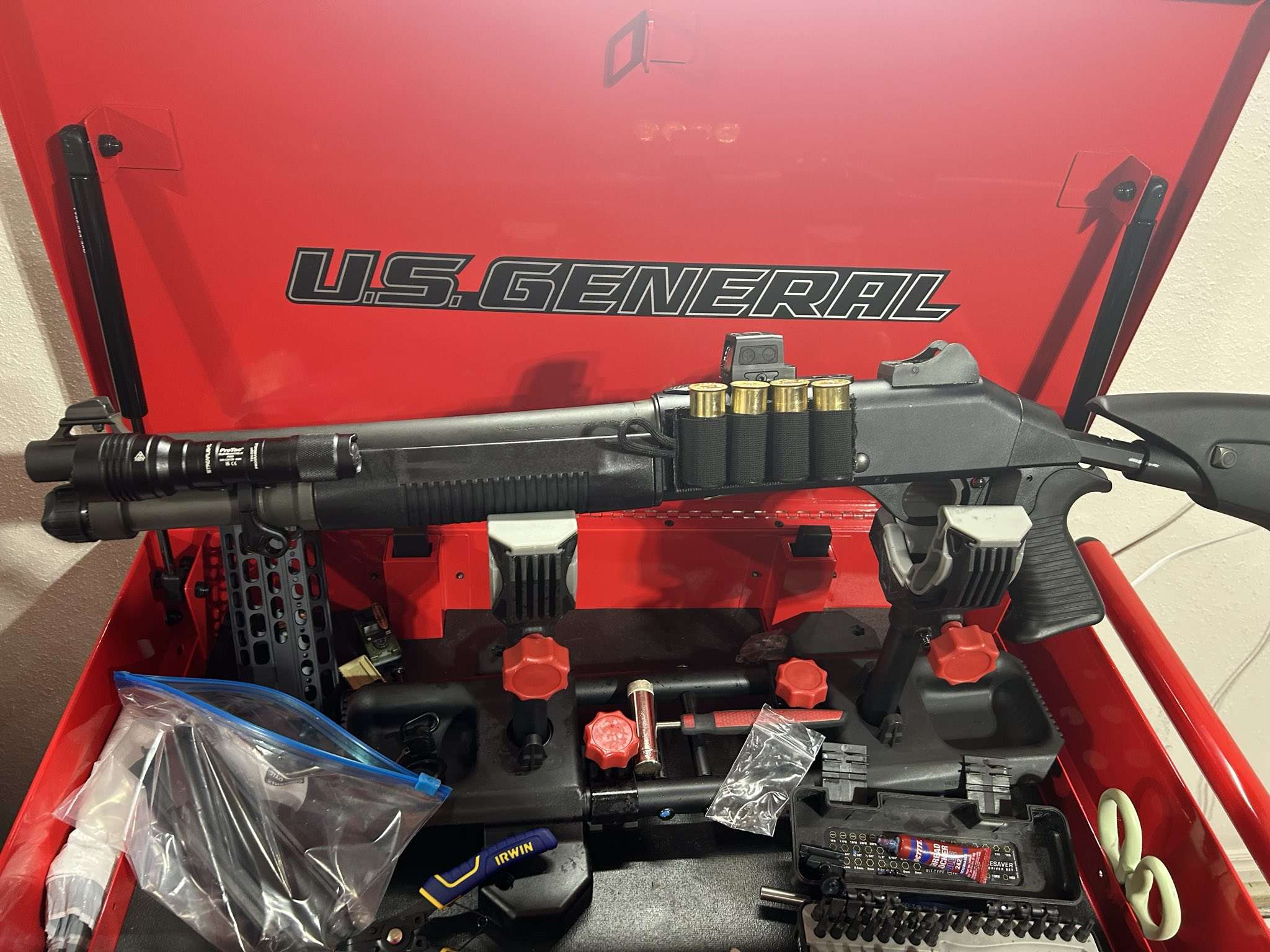

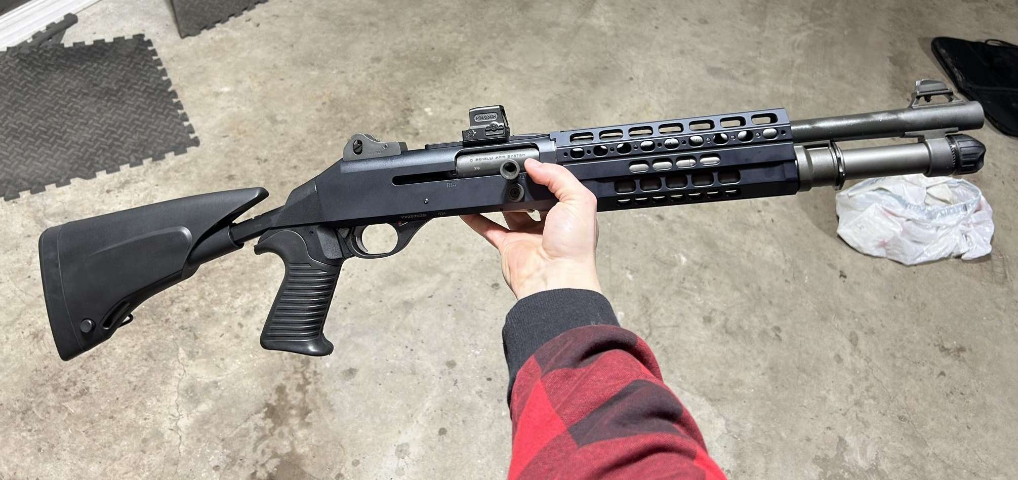

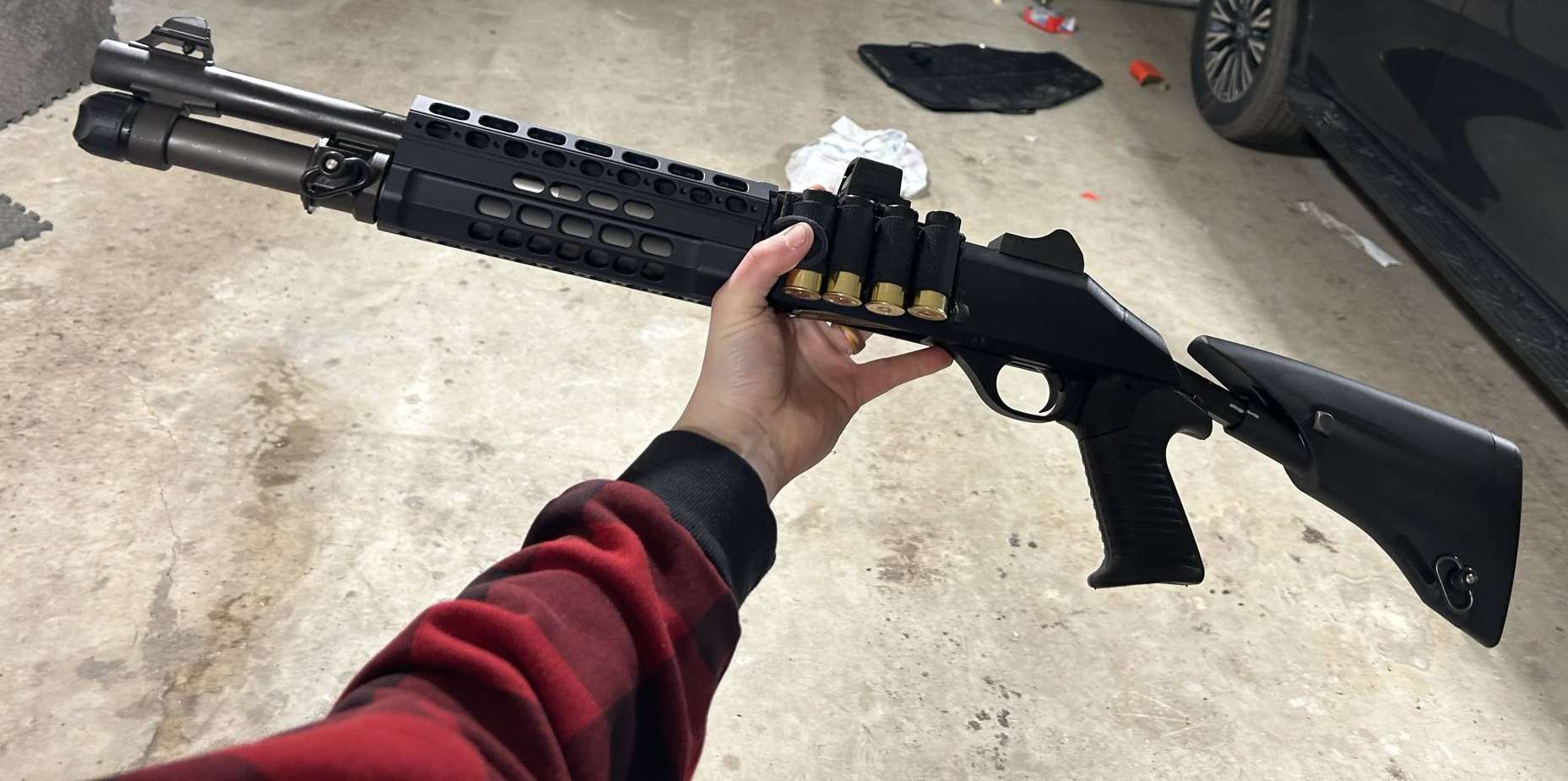

  2. I got a gen 2 entry but didn't really like the OEM railed hand guard. It's super solid and drop in, but its not actually Mlock and you have to screw pic rails to it, and having three layers of mounting is...sub optimal. I've read rumor's that the gen 2 hand-guards are to drain water away from the piston and gas ports for some military contract, but I am not raiding a oil rig from a semi submersible any time soon so I'd rather have the dirt and physical protection of the original's, and I can larp with it better. Here is the before and after. I used the Freedom Fighter Tactical hand guards as I couldn't find both Benelli OEM's, just the left side for some reason. But comparing them side by side the FFT's are of a higher quality plastic and fit better. You also need these three parts: Benelli M4 & Super Black Eagle 3 Spring Washer Benelli M4 & Super Black Eagle 3 Washer Benelli M4 & Super Black Eagle 3 Retaining Ring Also, the MSP/IWC light mount will NOT clear the gen two hand railed handguards, the light body will by about 2mm at the end threads but there is no way of any tail cap of any type to fit. Also drop in, and now I can larp Ready or Not in my barn with the cows.
  3. I have a factory 14" entry model that's the gen 2 with the newer railed hand guard and I want to swap to the gen one clamshells. What do I need to swap it back? Based on the parts diagram I need these three parts. Benelli M4 & Super Black Eagle 3 Retaining Ring Benelli M4 & Super Black Eagle 3 Washer Benelli M4 & Super Black Eagle 3 Spring Washer Since no on has the OEM's in stock I ordered a set of freedom fighter tactical reproductions I hope will fit good. So, I get those three parts, stack them as the diagram says during reassembly and I am golden? Thanks.
