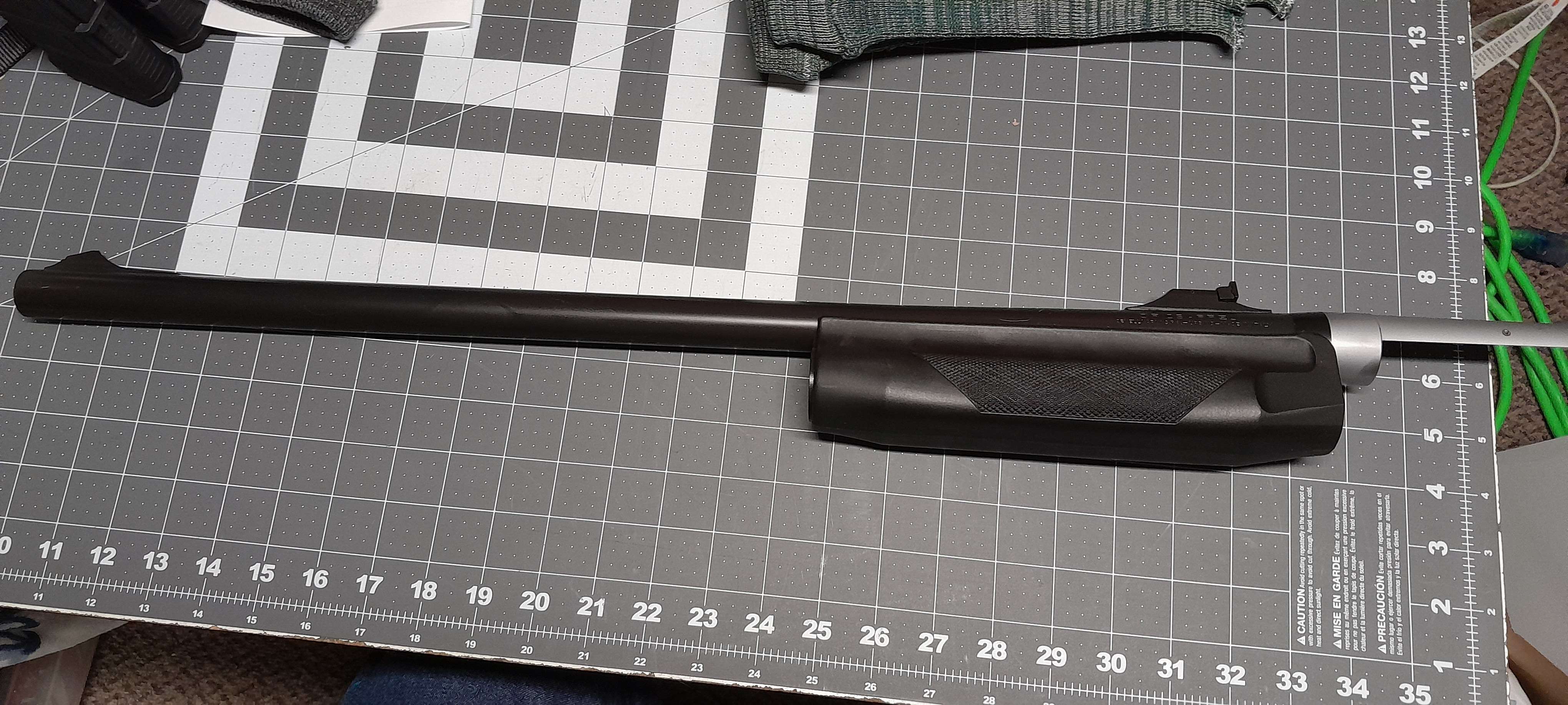

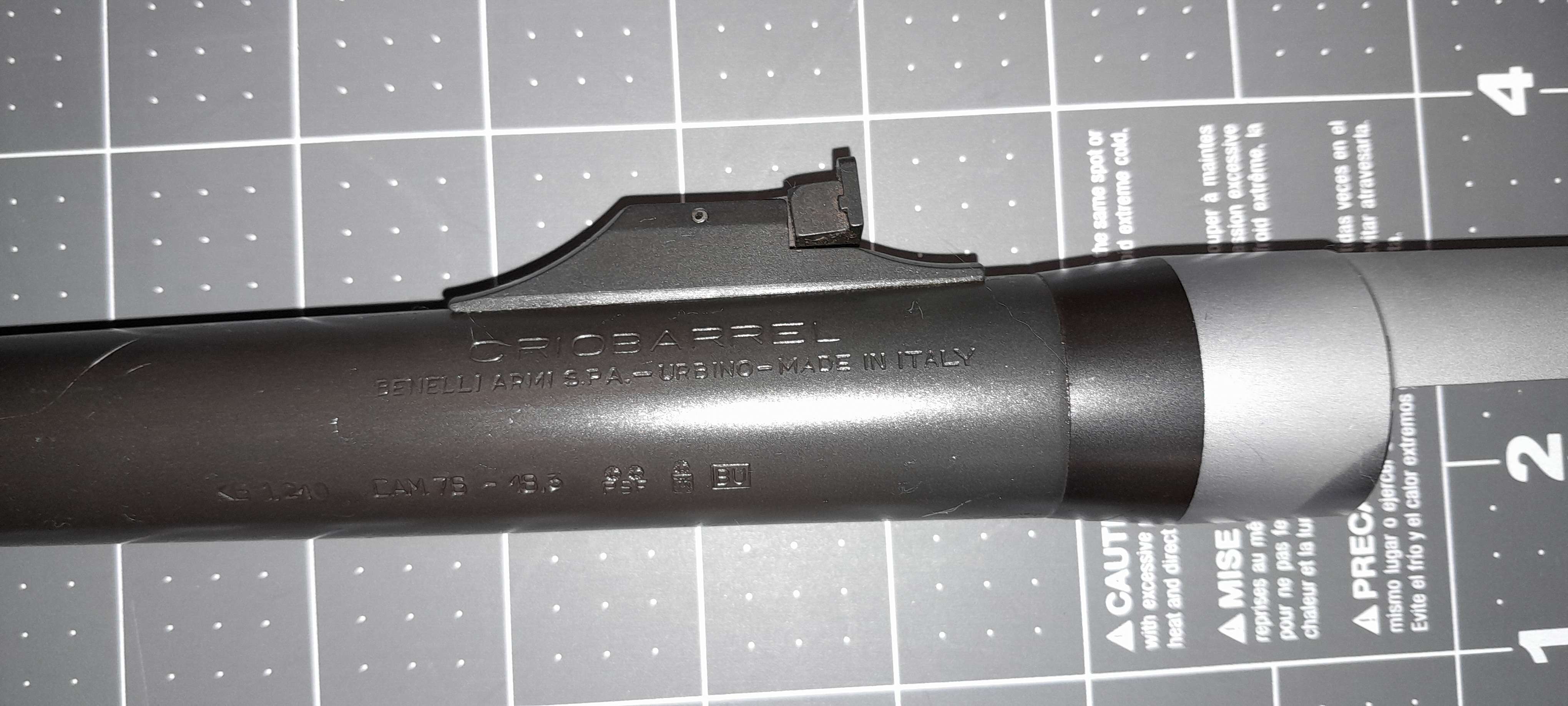

  1. I picked up a M1 super 90 and it came with this extra barrel which I have sense traded. The place I traded wasn't going to give any extra for this barrel and I know barrels can be worth money so I kept it. But it came with this criobarrel and was wondering what a good price would be to ask for it I cant seem to find this set up new to even begin to guess a price. But from what I can find it should work on the m1 or m2 and the forend is what was with it when I got it. This is a 12 gauge barrel.
