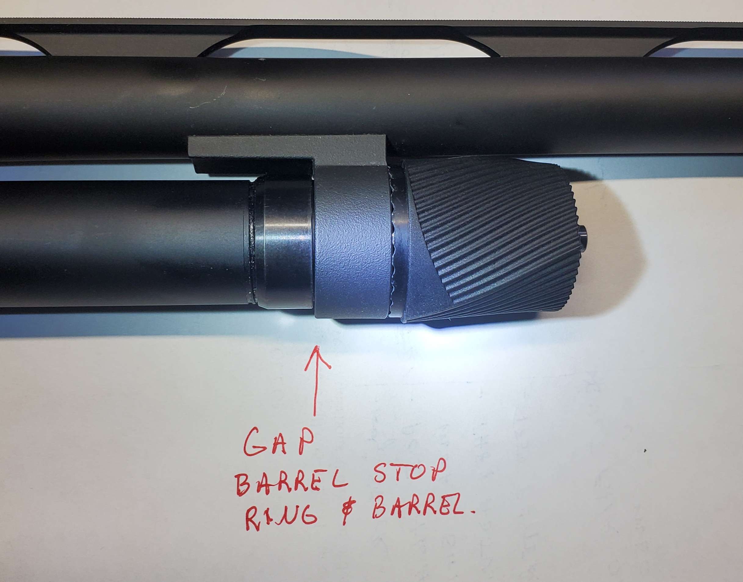

  2. Remarkable, thanks again for your feedback. 1. I will take your advice on the Hi Viz Comp Sight, that looks like a good solution. 2. The photo of the barrel stop/lug gap is of my gun after Benelli repaired it. I was concerned with the gap when I noticed it, contacted Benelli, and they had me ship the gun back for inspection. They sent it back in the same state with a test pattern ,and said it was properly adjusted. I'm OK with the gap, but my engineering mind questions the function of the stop ring if its not making contact with the barrel. I must note, following the barrel replacement and adjustment of the barrel stop ring, the POI was better from L-R and lowered some. Please don't insult me by saying this photo is not of the gun I have. 3. I have 2 test patterns for this gun from the Benelli repair shop, and the folks performing the pattern test wrote the letters "POA" on the target and circled them, not me, I only drew the horizontal line through the target. If you look at how Browning conducts POI tests, they use a 6 o'clock hold on a 6" bull also, using the top of the bead as the POA. I was just wondering how Benelli conducted their POI testing. As a matter of fact, I was planning to perform a POI test with this gun using the Browning method to see the results. See Browning POI testing procedure link: https://www.browning.com/support/faq/shotgun-poi.html?srsltid=AfmBOopnPKogNlMUfViASqNMAa_KXWqSOMJZItIohP4v5c0MEHjuq4aI Now that I'm older my back really appreciates light weight well balanced 12ga shotguns, and that's why I inquired about the Montefeltro. Do you think the Ethos would be a good fit for me? Thanks again for your help.

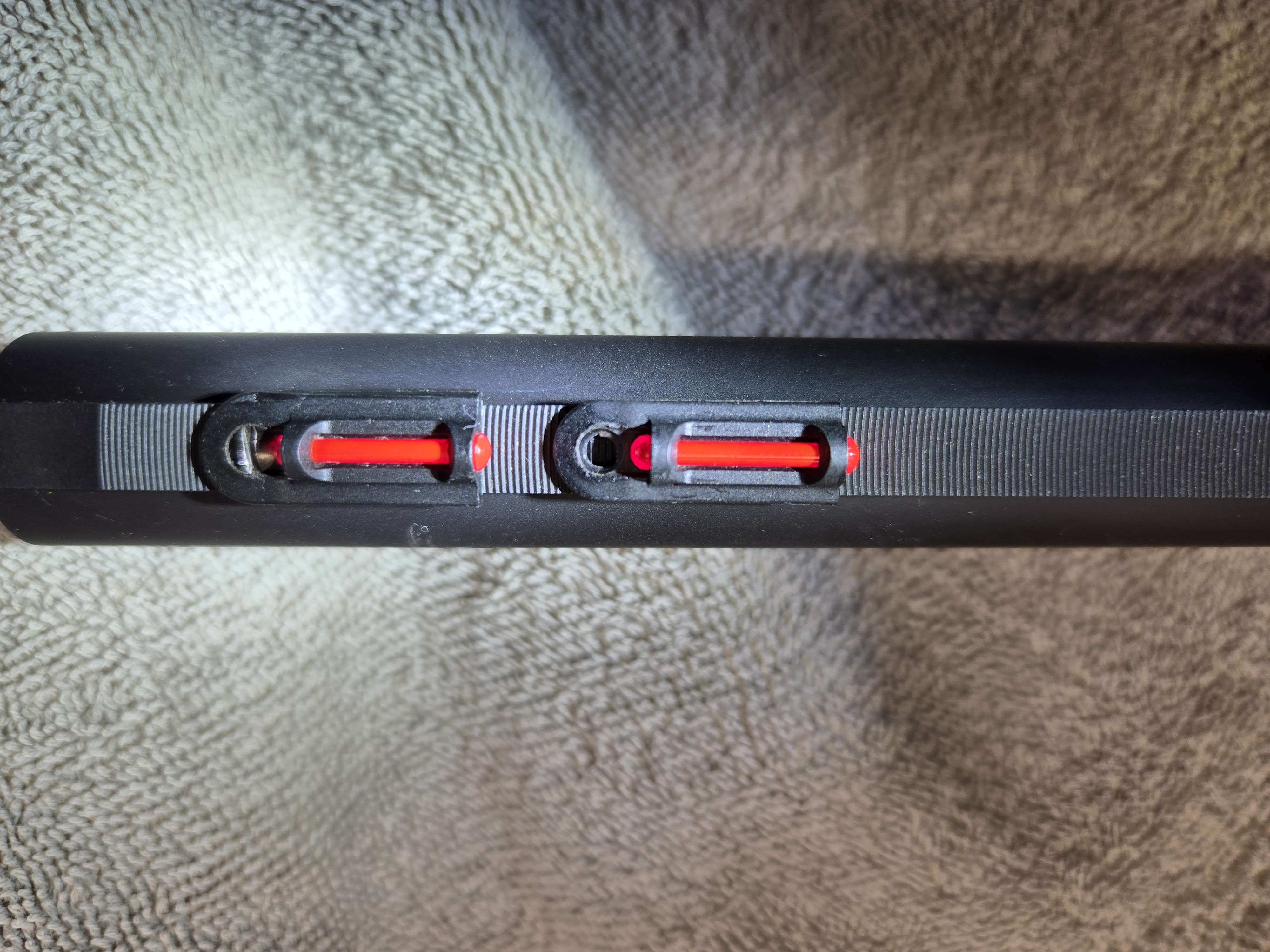

  3. Remarkable, I appreciate your feedback, please clarify the following: 1. Where can I obtain another front sight like the one that came with the replacement barrel from Benelli? The one I have is cracked. 2. What is the purpose of the barrel stop ring if it isn't making contact with the barrel lug. Is it for vertical support of the barrel? 3. When the Benelli gun shop performs the point of impact testing, where is the front sight with respect to the POA indicated on the test target? Is the top or middle of the front sight aligned with the POA indicated on the target? Thanks
  4. Attached is the new barrel provided by Benelli, which has a larger sight than the original, which seems like an attempt to lower the point of aim, thus lower the point of impact. Note, I contacted Benelli to purchase a replacement sight for this new barrel and they said this sight was unavailable, and that they could not understand how this barrel came with this sight in the first place. The sight they ended up sending would not fit my barrel, must be for a smaller gauge barrel. The second photo is of the gun repair Benelli made by moving the magazine tube barrel stop ring so that it is no longer making contact with the barrel lug. What is the purpose of the barrel stop ring if it no longer is making contact with the barrel? On the Benelli test target provided after their repairs, they noted the "POA" being a 6 o'clock hold on the black bull. I drew a line through the "POA" and counted the pellets, which resulted in a 80/20 pattern. My plan is to trade this gun on some other light weight 12ga auto that I can use for my upland hunting. I like the Montefeltro but am gun-shy to make another Benelli purchase. , which

    Buy the A400, my son has had the A400 Extreme for 4 years and it has functioned flawlessly, and he hunts 3-5 days per week and rarely cleans his gun. I sold him my A400 Lite and bought a SBE3, what a HUGE MISTAKE!!!!! My new SBE3 shoots high 80/20 and left of center, looking straight down a flat rib. Benelli basically told me to pound sand, the gun is designed to shoot high. It's currently at the Benelli repair shop for the second time to inspect their previous repair job, which appears to be a safety concern.
  10. I've got the same problem with my new 2021 SBE3 shooting high 80/20 and left. Sent it to Benelli and they adjusted the barrel stop ring in attempt to correct the POI, which didn't improve. Now the gun is back at Benelli because my barrel lug has a .015" gap between it and the barrel stop ring, following their original repair. I sent an email to Benelli's Carter Miller explaining my concern with their botched repair and it fell of deaf ears. Now I have a gun that was potentially damaged because of being fired with the barrel stop ring not being in contact with the barrel lug. I never expected this kind of poor quality and unprofessional service from Benelli. Do not buy a SBE3 unless you pattern it first! Also, Benelli's canned response that European guns shoot high while looking down a flat rib is false. I've been calling Benelli dealers every day to share my story and they all agree that when looking down a flat rib the gun should pattern close to 50/50. One can raise the stock if they choose to raise the POI of the gun. Now I'm waiting to get my SBE3 back from Benelli's repair shop, so to ensure that it is still safe to shoot prior to trading it in and taking a huge loss on this $1500 boat anchor.
