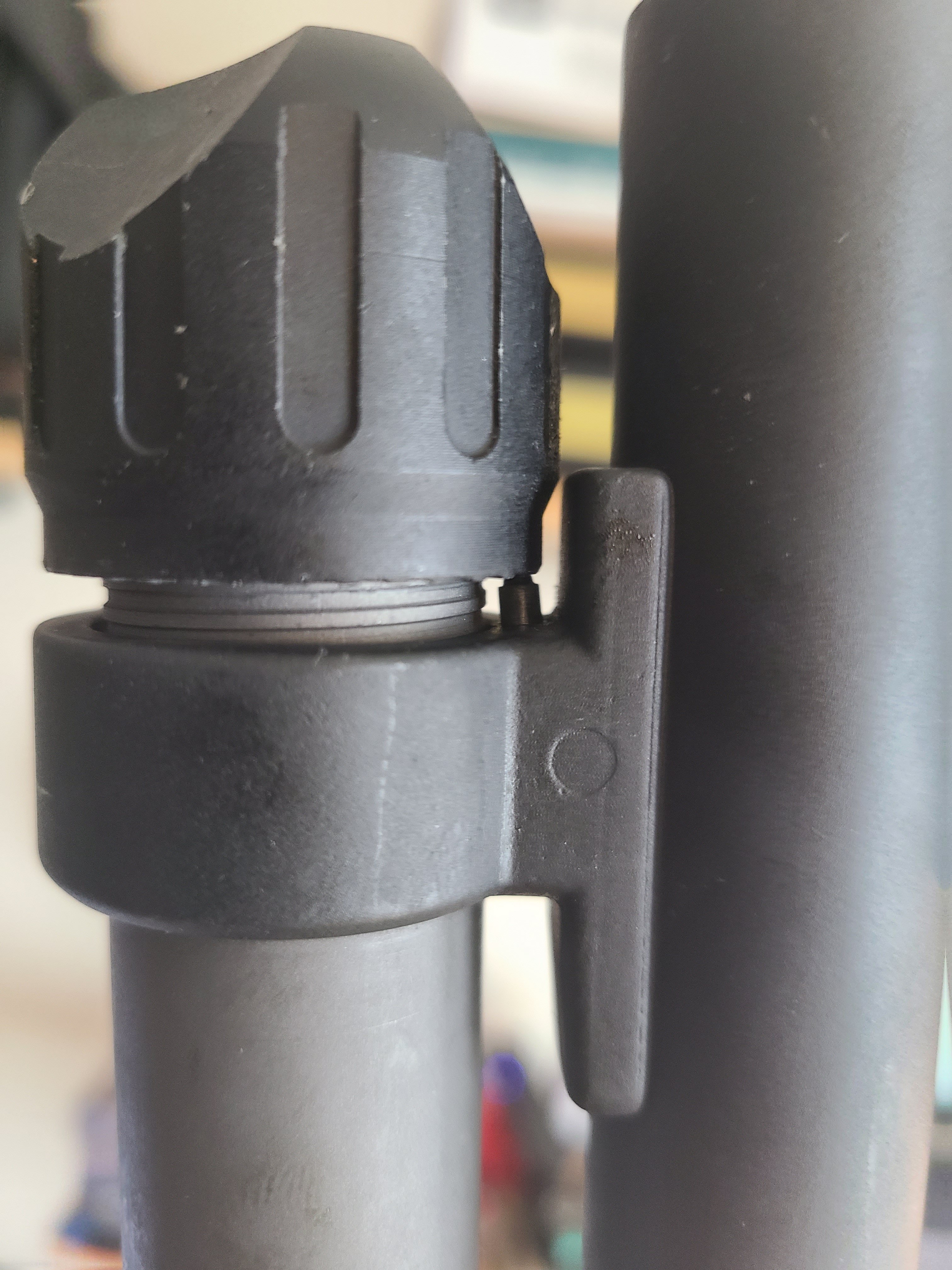

  21. I installed a Carlsons breacher choke on my shotgun, and when I took it to the range today, it seemed to have adversely affected the cycling of a few of the rounds. It wouldn't completely eject some of the rounds, and they were also a couple of small jams. But- There are two variables at play: one was this new choke, and I also used a new type of ammunition I've never used before. It was federal premium hunting ammunition/ rifled slug with 1600 FPS (so, that shouldn't have been the cause...) Do you think the breacher choke caused the cycling issues?

  23. I think any residue left behind from using oil/ solvents inside of the piston sleeves can cause the o-rings on the pistons to prematurely erode
