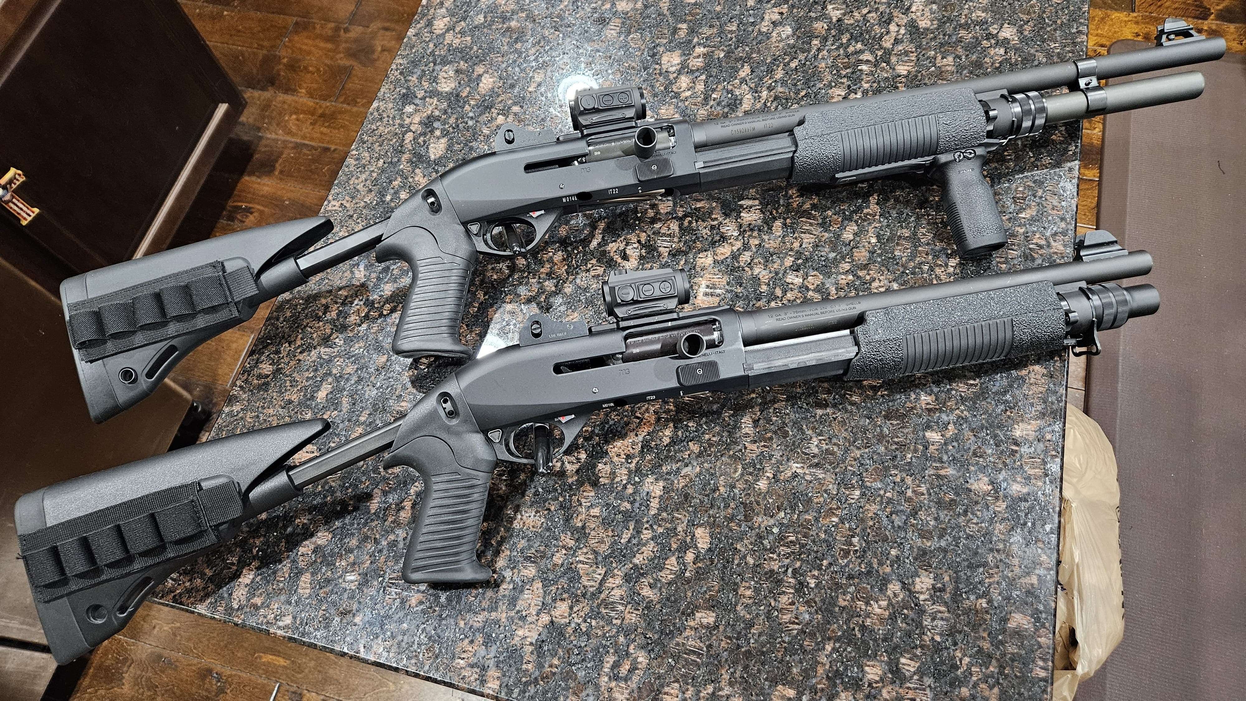

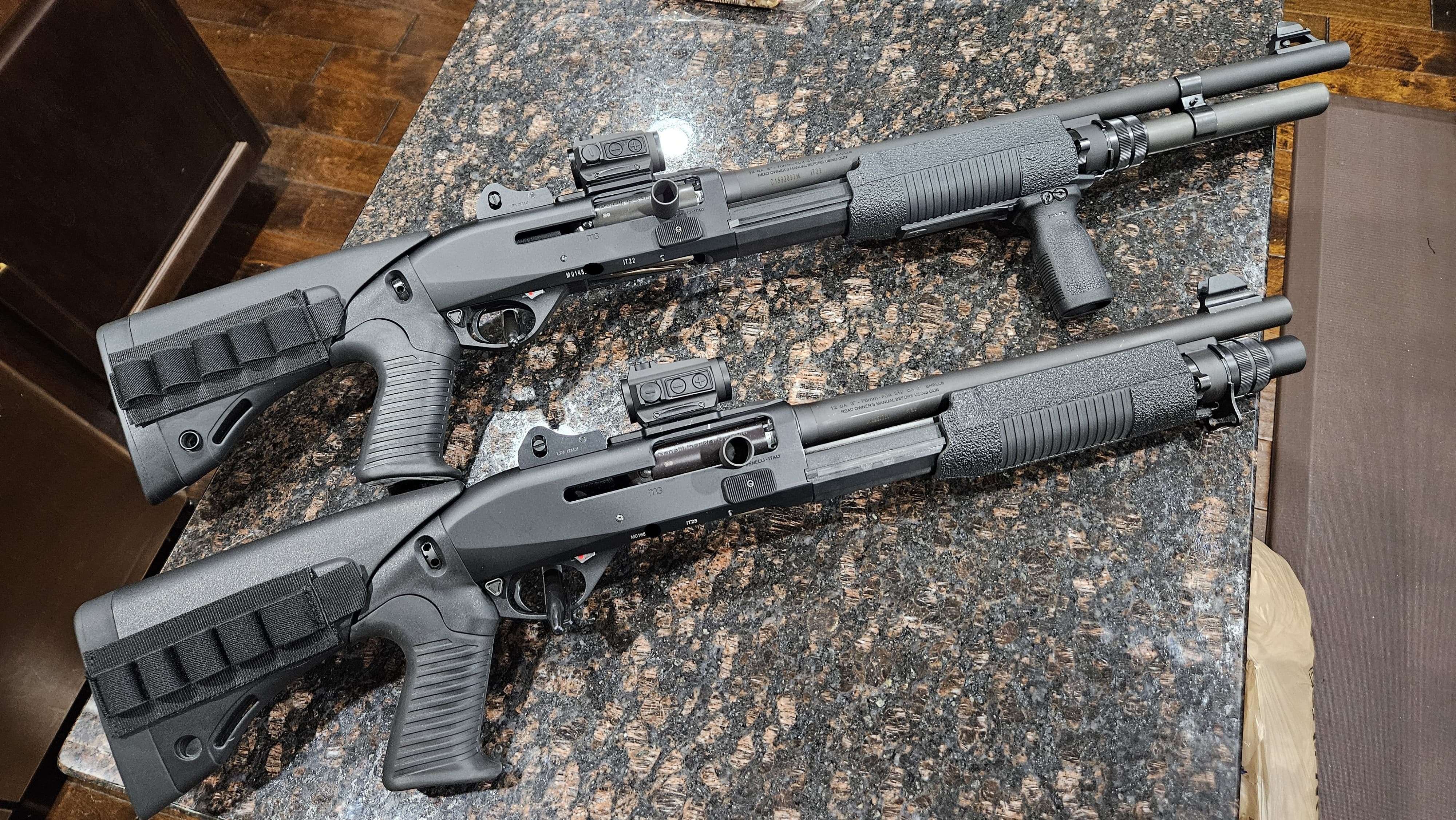

I was able to track down a completely new M3 (# 11606) that was just a 5+1 model that already had the short magazine tube cap, so no part number on hand at the moment. Contact Benelli CS and ask for the standard mag tube cap for an 11606 M3 (5+1 model). Mr. Carter Miller is the Benelli CS rep we use when it comes to Benelli parts questions, but he's tough to track down at times. Good Luck!
Rose Action Sports cut the barrel down to 14" exactly for a perfect fit with the mag tube end cap (no threads on this particular barrel). 14.5" would have extended a bit past, as I wanted everything flush for tight quarters w/ stock fully collapsed. Very nice cut & crowning work by RAS might I add... We tried to heat up the original front sight to "un-solder" it for re-use, but that was a no-go. At the time, no Vang-Comp sights were in stock/on hand, so we went with a LPA front sight w/ tritium insert from Fusion Firearms: https://fusionfirearms.com/lpa-front-shotgun-sight-low-solder-on-tritium Since the sight is "adjustable", co-witness with original rear sight was no problem. Let me know if you have any additional questions or concerns. Semper Fi!

Got the barrel back last week, with the cut & crown work expertly done by Rose Action Sports. This M3 Tactical SBS is now on par with my M4 Entry SBS, and now the solid break-in(s) can begin (plus, the weather will be getting "better"). Not a bad looking pair...
