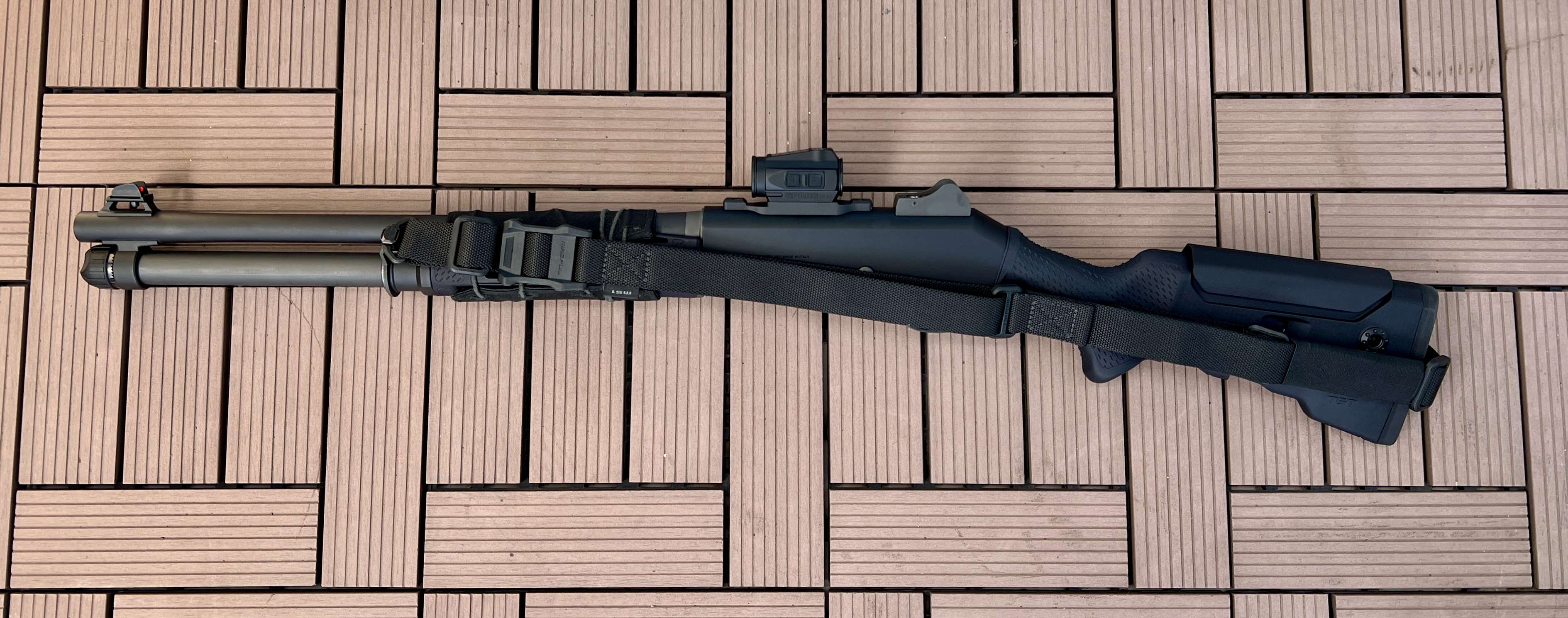

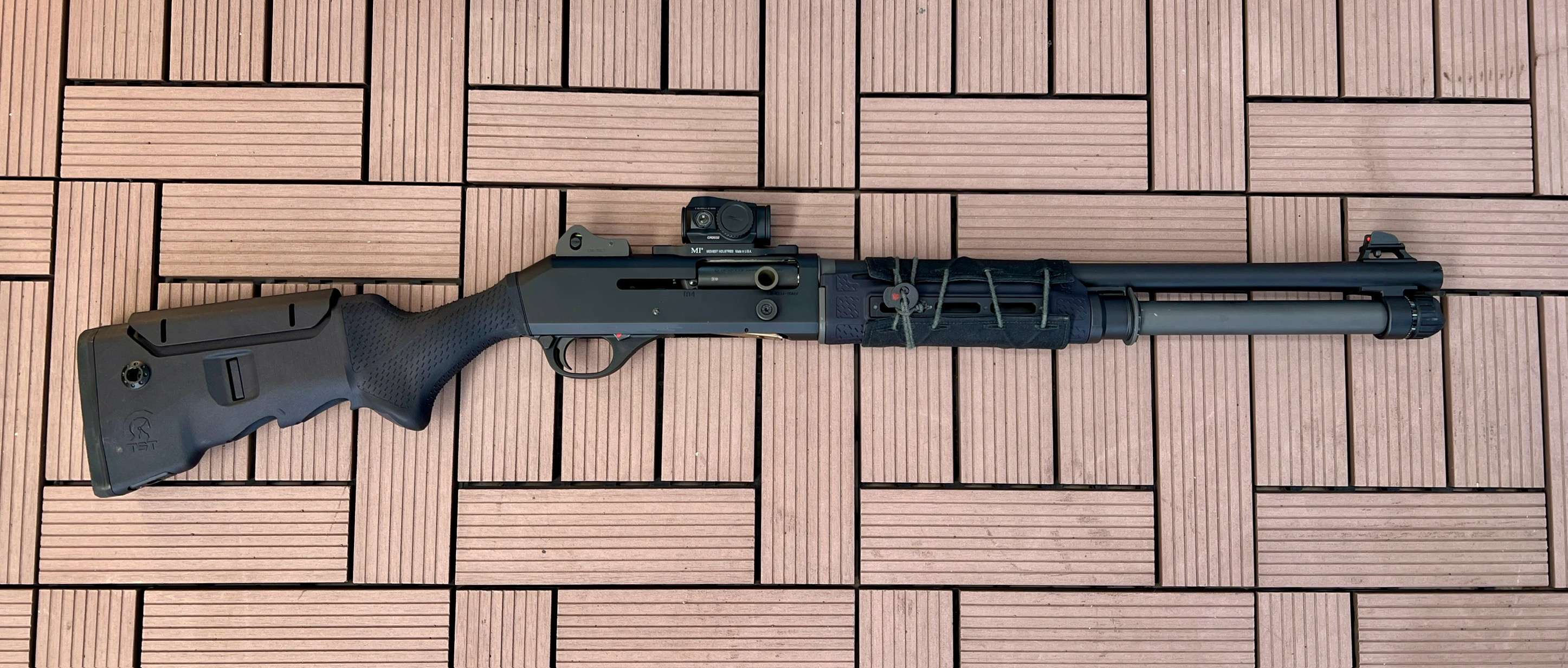

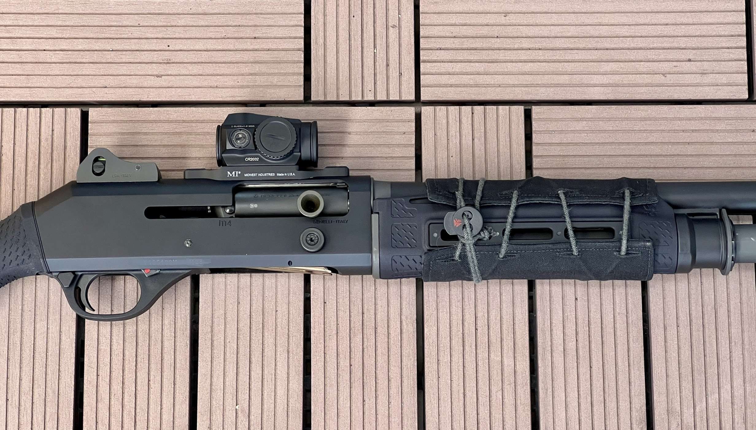

  9. Kudos to RxArms for tool less approach. I will never install anything on my M4 that will require tools to disassemble the gun.
  10. CEBEP
    M4 heatshield
    Check burn proof gear rail wrap. Adds no extra weight to the shotgun and removed/installed in seconds. That’s what I have on my M4.
