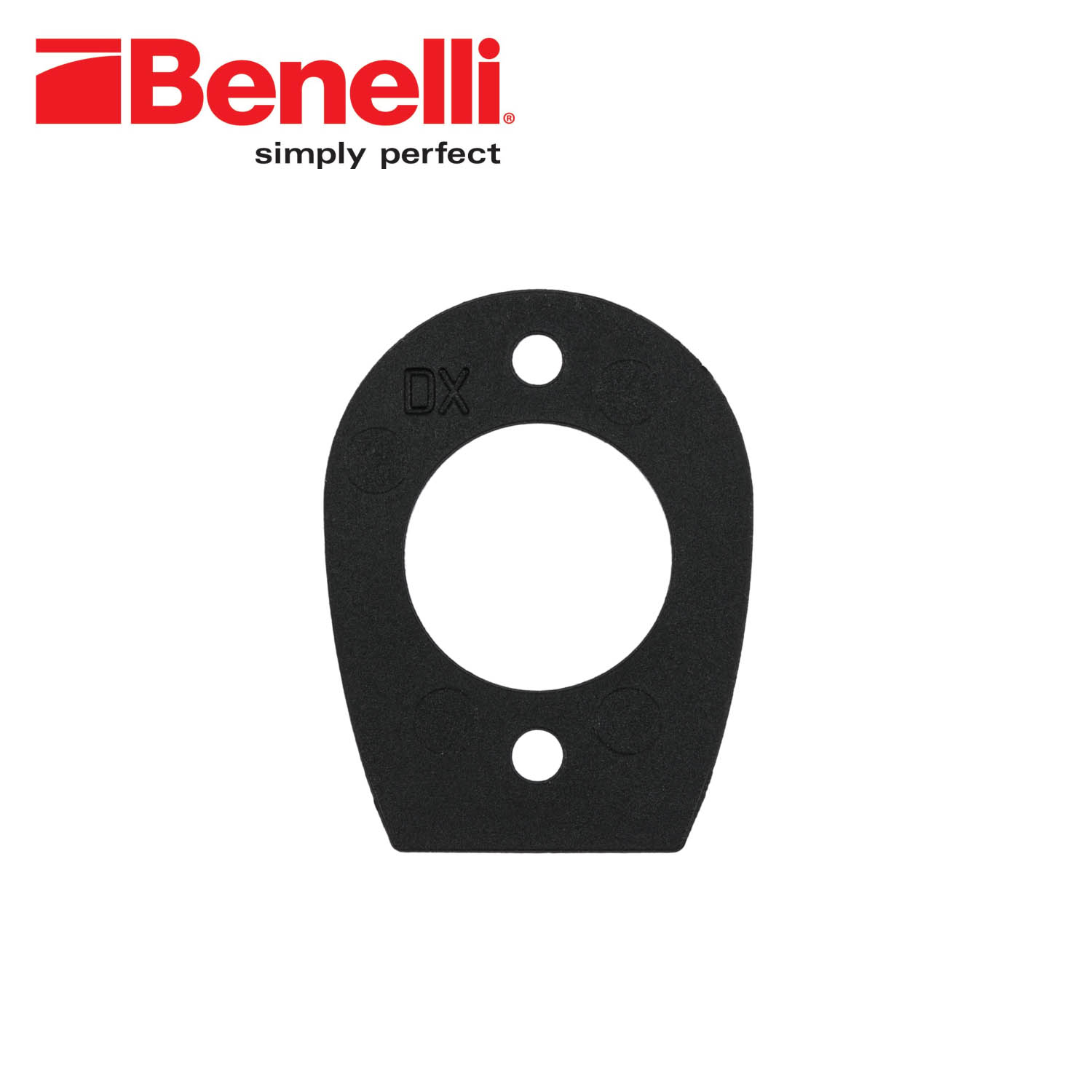

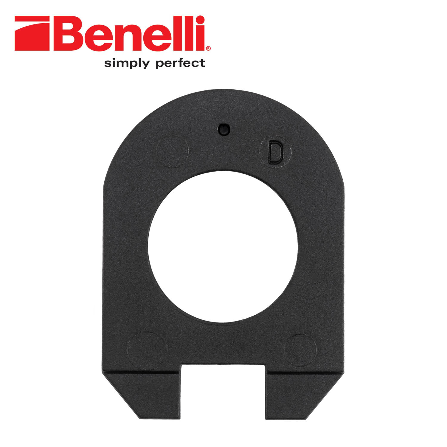

Doge Posted March 19, 2022 Share Posted March 19, 2022 There's no official documents about parts and stuff for the public, so I am making this up as I go: The NZ M3 uses the plastic stock originally from the Supernova. It is also shared with the newest M3-A1, MR1, M4-A1, & GLX160. It is special because they reuse the M1014 grip. The tube you have posted should work with your M3. The back end should be threaded for M21 x 1 screw threads. As long as it doesn't say H&K on the side that's a good indicator it has the M21 screw threads. You would just need to use the M1014 grip. It is squared on the back to line up with the M3 receiver. You can look at stock shim kits to see the different shape. The curvy shim won't work with your gun; which also means the curvy the grip won't work. Some people bubba the grips on and they mismatch. 1 Quote Link to comment Share on other sites More sharing options...
