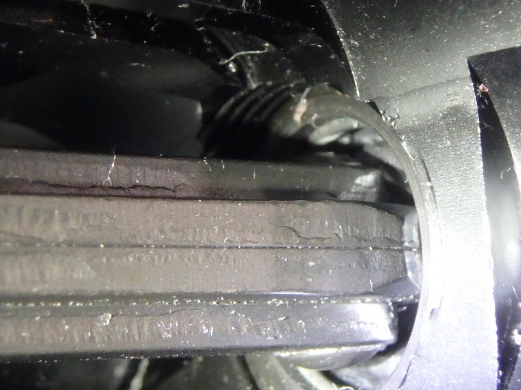

Extremely disappointed with my my brand new Benelli M4
The link is #43.
The bolt carrier is #29.
The link is attached to the carrier with a pin.
Some of the “peening” below the cup is rather indicative of dimples caused by jamming the bolt carrier into position without guiding the link into the cup. These marks are rather common and usually owner created upon assembly.

But that doesn't account for the drag marks all the way up the arm..or are they drag marks at all? so hard to tell by pictures alone. But I see and understand what your saying M2.

I had no idea they were welded, I thought they were just pined.
I took a few pictures of mine and by looking at them it appears that maybe his recoil tube may not be screwed all the way in?
What do you think?

Just going off what I was told from a Benelli guy. While I haven’t seen copperish colored flux, I have seen silver solder looking like that
