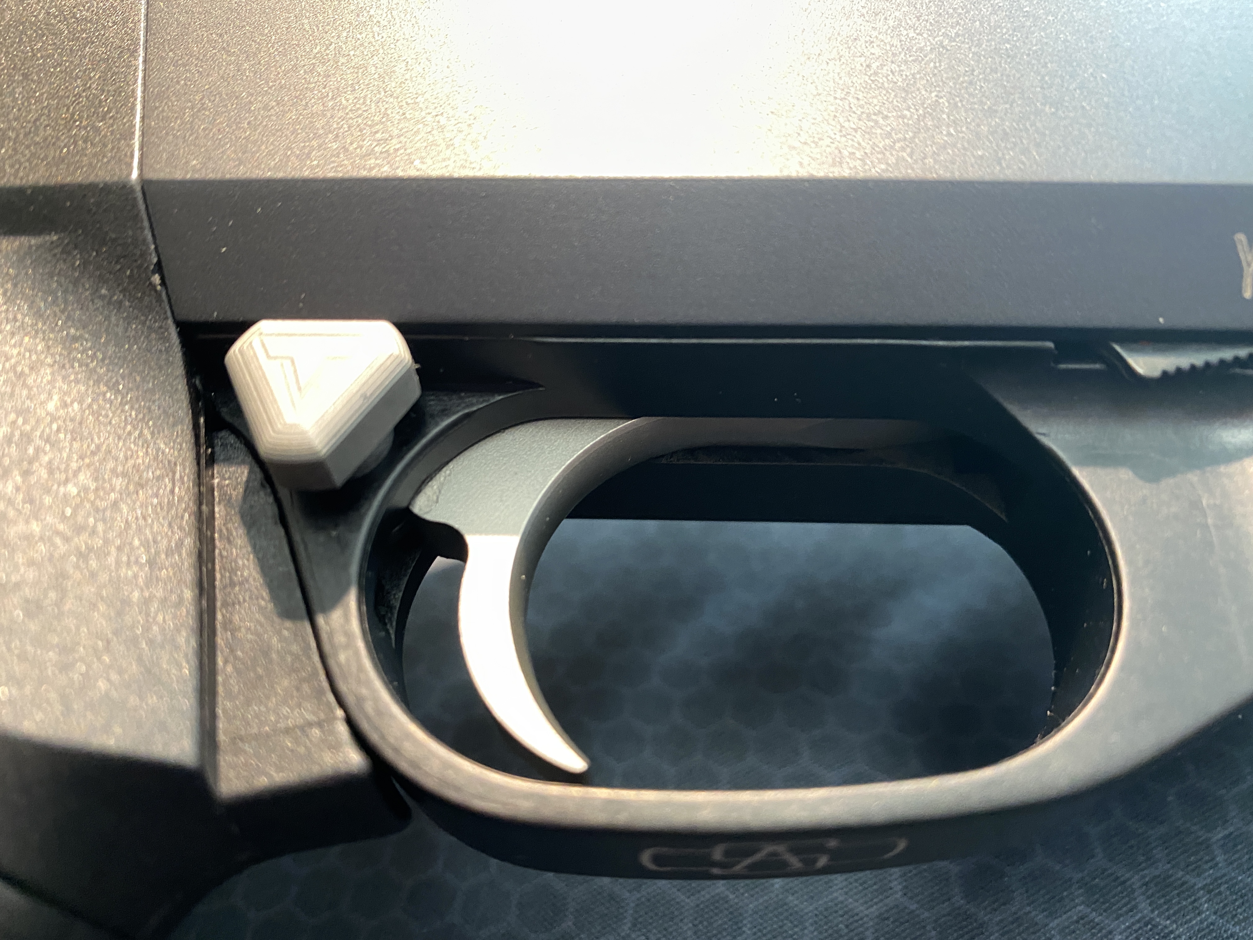

    Many thanks for all the knowledge sharing on the this forum which helped me personalize my M4. Upgrades: Collapsable stock, Limbsaver pad, FFT bolt handle, Briley CF mag tube with Nordic extended follower, GG&G bolt release, FFT trigger pack with A&S Trigger guard, TTI extended safety, TTI extended carrier, Carlson breach choke, Tango Arms stippled forearm, and Meprolight night sights.

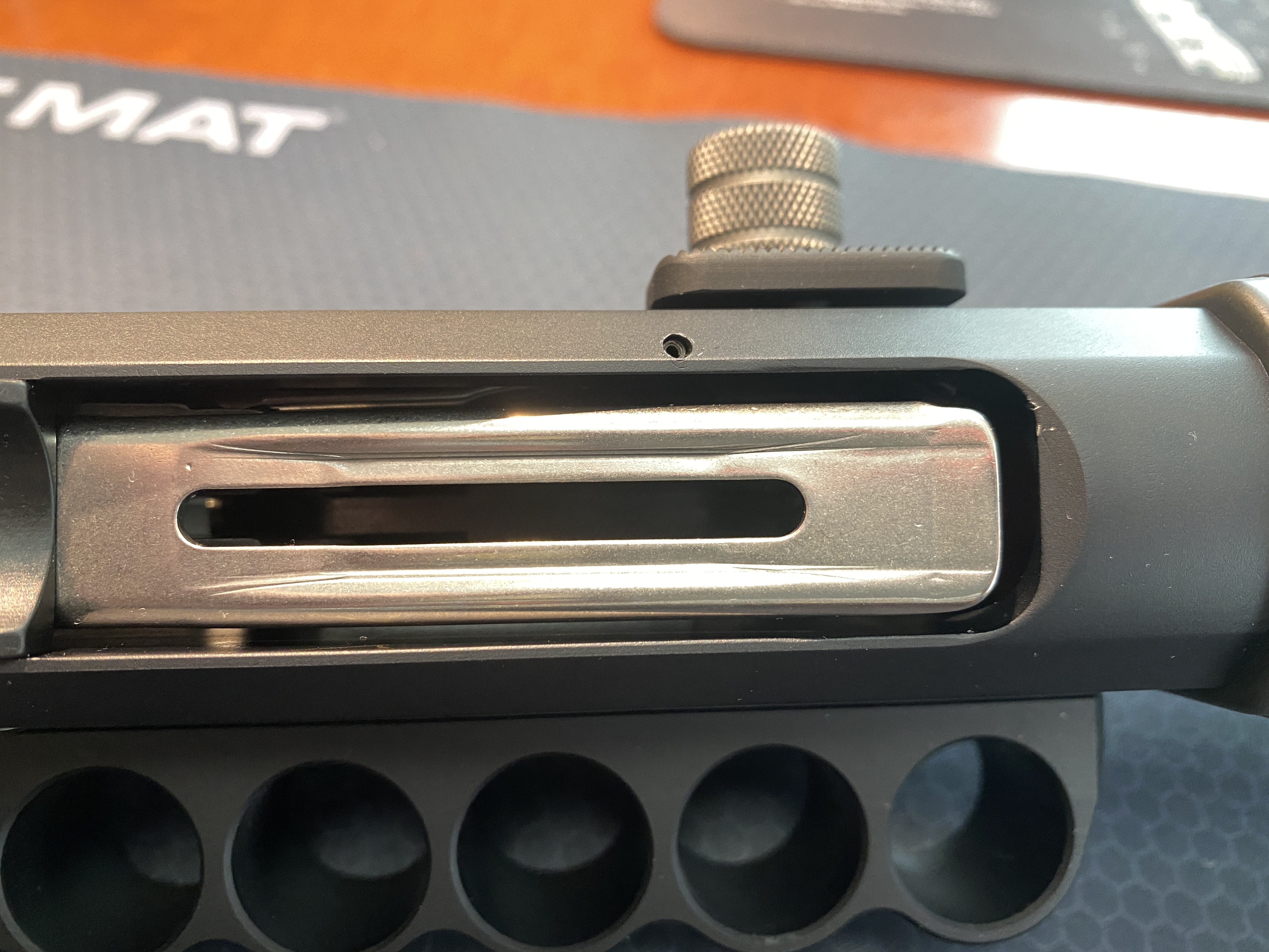

  12. Installed the Briley CF tube with the extended follower made by Nordic. Really like looks.

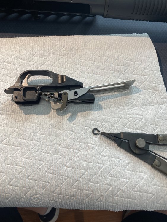

  14. I used the Powerbuilt tool from Amazon to install the spring clip today. The tip was just a tad wide. It probably would be fine with a little fiddling but I decides to grind/file little bit off one side of the jaws and it fit great without slipping.
  15. Another fan here of A&S Trigger guard. I like the A&S solution for the safety spring mounting.
  16. So if the M3 style trigger guard pin spring is easier to remove for maintenance any idea why Benelli went to the M4 style pin spring? Any noted failures with the M3 clip? Does the M4 spring hold better? I already am invested in the snap ring tool plus two spare M4 style pin springs so I'm not changing but inquiring minds want to know....... ?

    ? I own quite few Sigs and spent a lot of time over on SigTalk. Mostly into semi custom 1911s now so haven't been there in awhile.
  18. Sorry I don't have any answer for your questions. Maybe a more experience member can chime in. I'm glad you found a work-around. Unfortunately past experience has taught me that just buying the right tool up front will save me extra time and money in the long run. I'll buy a tool even if I don't think I'll use it again. Of course I don't always follow my own intuition. Case in point I was able to remove the pin spring with a generic snap ring pliers. Broke the first set of replaceable tips on the pliers but after a couple of tries got the spring off......well it actually got itself off by shooting itself across the room?. So I went and bought a more expensive set of snap ring pliers to reinstall. Worked OK but spread the ring a little too far and broke the spring in half. ? So now after ordering a new spring clip and spending $13.00 on shipping I finally find this thread and hopefully got the right tool. Good thing I like to tinker and didn't need the M4 for awhile ?
  19. I Just ordered these from Amazon. I let you know how they work when I finish my trigger upgrade next weekend. https://www.amazon.com/gp/product/B002INOFSA/ref=ppx_yo_dt_b_asin_title_o00_s00?ie=UTF8&psc=1
