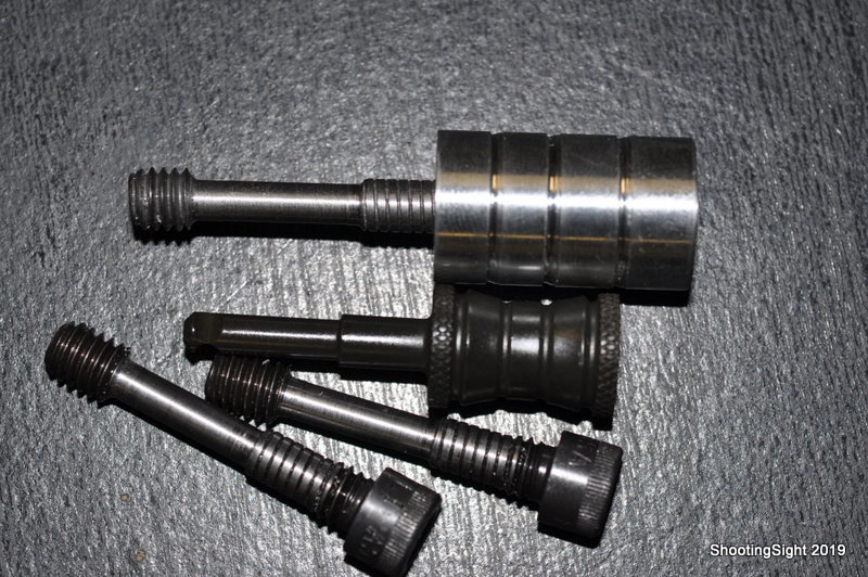

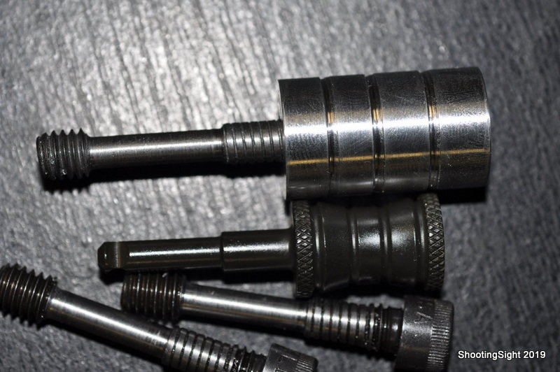

So here is what I'm playing with so far.  I got Grade 8 alloy bolts, which I'm turning down so they have 1/4" of thread, and then are a shaft.  Thought is I'll turn 3/4" hollow aluminum handles that are cup shaped on the CNC lathe, so these alloy bolts will thread through from the inside, and I'll have alloy steel shafts with aluminum handles.  People who want weight savings, or want anodized colors, can get it without sacrificing the strength of the shaft.
I had hoped that the larger diameter would get down to the thread base, and it didn't, so it looks a little amateurish (which is fine, because I'm not being paid to do this).  I'm not going to worry for these prototypes.  I might make a few where I just go a little deeper, to clean it up.  Ultimately, I'll do the shafts on a screw machine, so they look decent.
I'll dress a grinding wheel to create the radiused cut, and add the 3 cuts on a surface grinder.
The head of these bolts is 1/2", so I have 7075 bar that is 3/4".  1/2" hole in one end means it will have 1/8" walls, so I can add a few grooves, or a slight hourglass cut. or maybe some knurling.  If anyone has ideas for what they would like to see and/or can sketch it up, post a picture or just describe your ideas, I might be able to try them out.

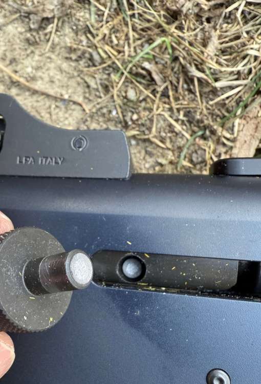

I was very much impressed with the 1/2 inch steel version from Freedom Fighter Tactical in terms of the fit and ergonomics. . .until it came flying out of the weapon and onto the floor at around the 70 round mark. This was with a Benelli M4 14-inch using Winchester #1 buckshot 2 3/4 inch shells (16 pellets). I would personally like to see something like this, but which is bet-your-ass reliable in a self-defense context.
https://freedomfightertactical.com/collections/benelli-m4-tactical-shotgun-parts-and-accessories/products/the-freedom-fighter-tactical-half-inch-diameter-steel-tactical-charging-handle-for-benelli-m4-shotgun
Whatever you make, above all else, it has to NOT spontaneously eject itself from the bolt carrier when firing the weapon.

That seems to be the sticking point with these AM bolt handles....they are not reliable in that, the detents are not done correctly so that they don't eject or fall out of the bolt carrier.
There also may be a question of proper steel hardness/wear resistance as well.
I happen to like the OEM handle both in design and aesthetically. The only change I would make to the OEM handle is to make it a wee bit larger but, not very much. It seems by the pics in this thread, someone has done that.
The question is if they do the detent cuts correctly to prevent unwanted disassembly..
